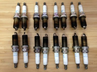

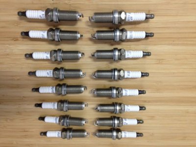

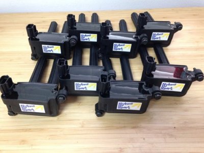

Stumbled upon a well priced set of NIB Sultans of Spark High Performance Ignition Coils for Hemi engines (part #45850).
As my spark plug change was due anyway, I figured why not upgrade to high output coils and longer lasting plugs. I followed Performance Distributors’ recommendation and used the appropriate Autolite Platinum plugs AP5325. (My early ‘13 still had copper plugs and the “low output” coils.)
I wasn’t expecting much from the upgrade - here’s my first impression after a 25 Mile roundtrip...
Idle was already super smooth with the old plugs/coils, still is, so no improvement here.
Butt dino didn’t noticed any increase in performance either.
MPG - same as before.
My personal opinion - it’s no improvement over stock, except for the longer lasting plugs. (Changing the plugs was a b*tch.)
Below some old vs new pics...
charonblk07
Mar 14, 2013
4,056
2,088
Calgary, Ab
2009
F1-A forged 349ci
I would not expect any difference with a stock engine or on an engine where the stock coils can keep up to the demand. I'd be interested to see what the difference would be with an engine that typically needs to close the gap like on a supercharged or nitrous application where you'd need a hotter coil to spark over a larger gap without blowing the spark out.
