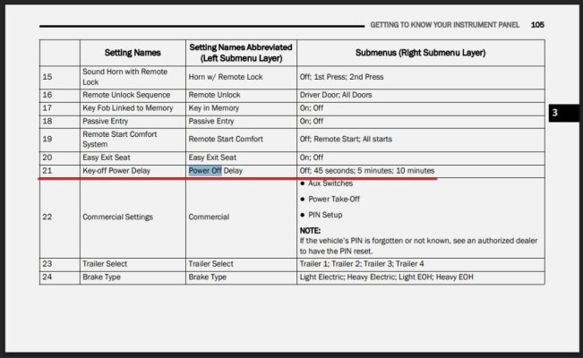

Look in the Uconnect Settings/key-off delay.

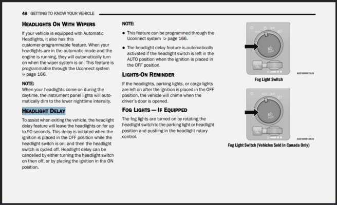

In somewhat the same situation with a new to me 2014. Just now, I am doing a self programmed routine. I get in and start up, push the Audio button, Audio Off comes up on the panel. Lights at shut off last about long enough for me to get out of the truck and close the garage door. Haven't programmed the garage door opener, I still use the module. I plan to have this truck for a good while and I like the quote from Crossfire Trail - "Well, see, if you take your time... you get a more harmonious outcome.”
I'm not certain of the available options on your Uconnect radio.
What is the model number of your radio?
The Owner's manual should list that info.
The Uconnect 4C/4C NAV 8.4" has options for the headlights on for approach and headlight off delay.
The headlight off delay is also activated by selecting the Auto Headlight position.
Cool -ish ! Line / button/ whatever #21 will keep power on for a while after turning off engine .
Is there any way to turn on power , without starting engine ? I hate to start engine for 5 seconds just to put window up / down .

Cool ! Just tested it , and it works !
To access the Uconnect radio settings options in my truck, and likely yours, the ignition has to be in the 'Run' position. Tapping the start button twice without stepping on the brake pedal will accomplish this without starting the engine.
