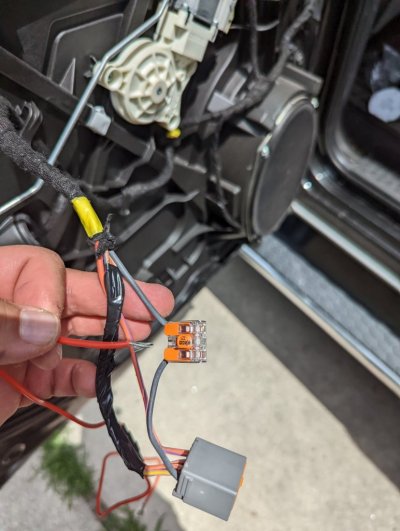

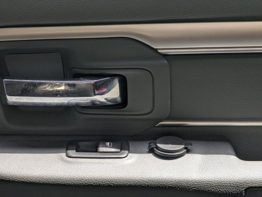

My 2018 Megacab Bighorn had no chargers in the back and that is a no go with the kids and road trips. I can't suggest this video enough.
It was really easy and I used some wago connectors to do the splicing in the event I want to make changes or whatever. My kids just tuck the cord into the door pocket when not in use. The only con is there is no constant line in the door (that my multimeter found), but I dropped in a dual QC3.0 & PD port charger on each side and it's been great. They can keep the tablets or Switch or whatever going for long trips now. Just wanted to share.
