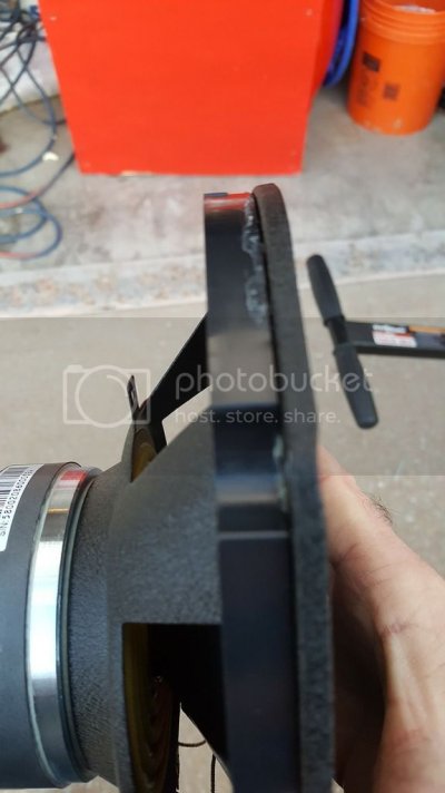

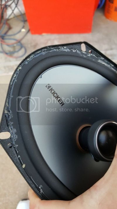

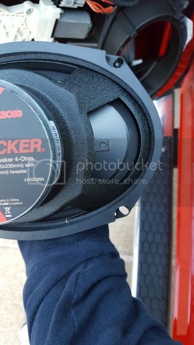

What I did was remove the Kicker 1/4" spacer on the front of the 6x9 and moved it to the back of the speaker. The spacer is glued to the front of the speaker, but came off very easily. No damage to the speaker surrounds. I used the OEM screws.
The rear supplied speaker harness worked with the front speakers.

The speaker with the front spacer removed.
A side view of the relocated spacer on the back of the speaker, ready for installation.
A rear view of the relocated spacer on the back of speaker, ready for installation.
