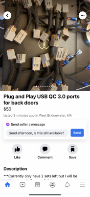

2B4CFA56-D8D8-4786-A5D9-5EBC150FBF17.png Looks like someone already has this for sale. I’d have went this route if available 2 weeks ago but still mine works good
