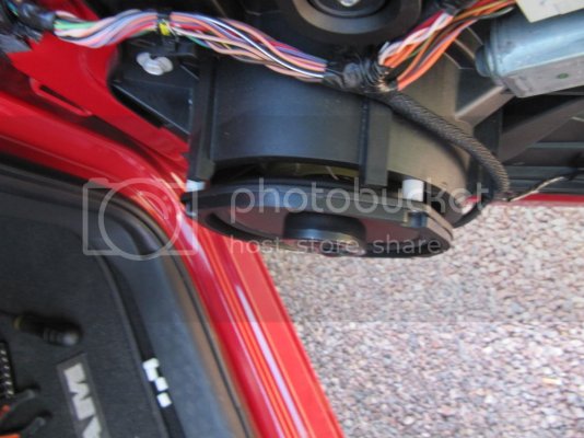

I bought the 1/2" spacers from home depot, about 89 cents a pack which comes with 2, then measured and marked the 1/3" line on them. Took a dremel with a cutting wheel and cut them down to size.
And here's a top view of the speaker with spacers installed
Now I know some audio expert people are probably going to chime in and say that there's a problem with my setup and that is that there's a gap between the speaker and mount. Yes for proper channeling of the speakers bass, this is a bad thing. I have yet come up with a way to enclose the area as there are no 1/3" thick ring spacers available that I know of and I haven't gotten around to making my own yet. I tried out a baffle today made by Boom Mat and was really unhappy with it and the baffle completely encloses the speaker and when I did a test run on the first speaker I installed one to, I lost almost all bass to that speaker. So I advise against anything that completely encloses the back of the speaker.

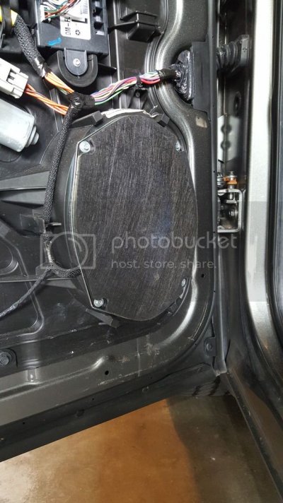

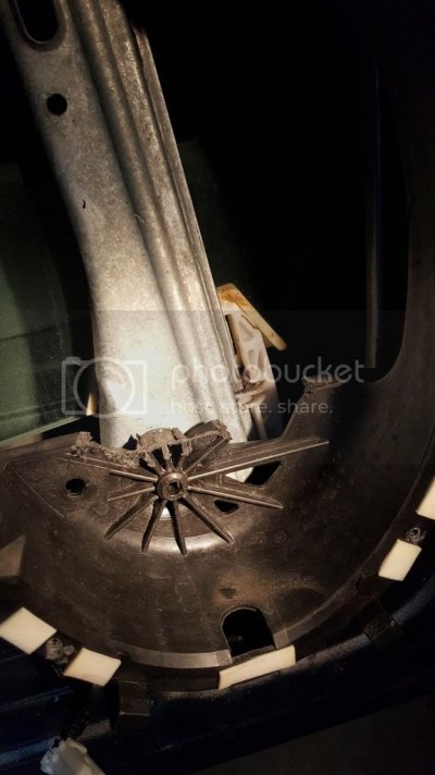

Yesterday I replaced all 4 of the stock 6x9 speakers in my 2013 Ram R/T with RA4 (Alpine) radio. To be clear, this install was on a standard cab Ram. For all 4 I used a plugin extension that plugged into the existing factory speaker connections. Metra 72-6514 Speaker Harness for Select Chrysler/Dodge Vehicles from Amazon.

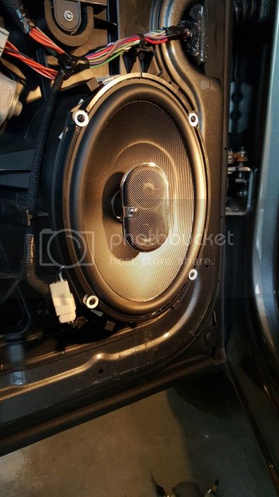

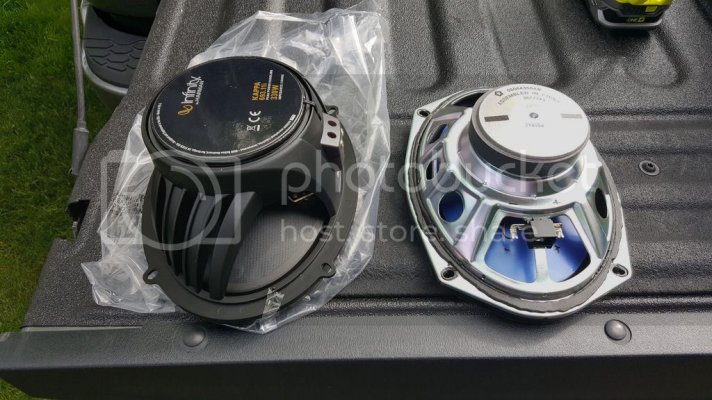

These are the speakers I got. Infinity Kappa 693.11i 6x9, peak 330 watts each and RMS 110 watts each. These are fine since I'm using the stock RA4 radio and stock amp. Note the huge magnets... that played a roll in how they mounted in the doors.
Summary of install follows.
REARS
Stock setup on rear
This was fairly straightforward. I used 4 1/4" nuts as spacers, redrilled holes that would not line up, secured them and sealed the edges.
DOORS
This took some effort to install.

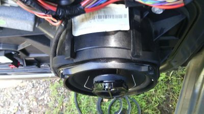

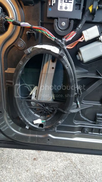

Stock speaker setup of doors.
Stock speaker removed (photo of other door)

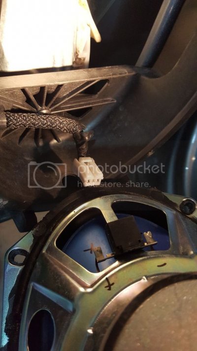

Note the speaker polarity. same on all 4 stock speakers.

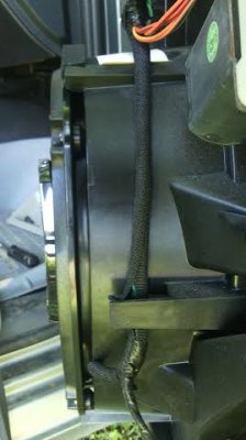

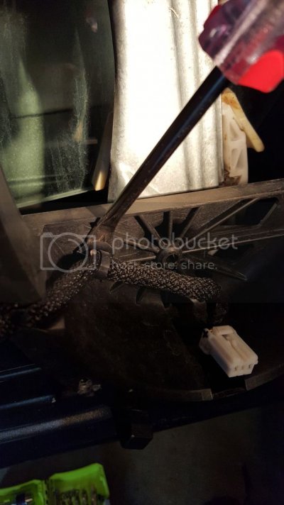

This harness clip was popped out and relocated out of the speaker well.

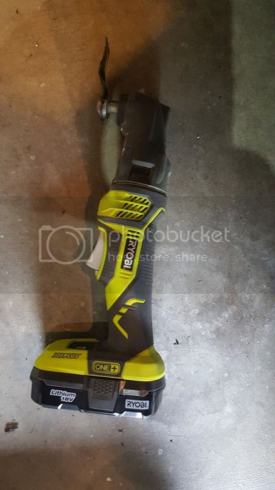

Tool I used for the next step. Loud as hell but it really made quick efficient work of the cutting.
Due to the large magnets of the Infinity Kappa speakers, I had to cut this area a little. Cringe if you must but the window rolls up and down no different than before.

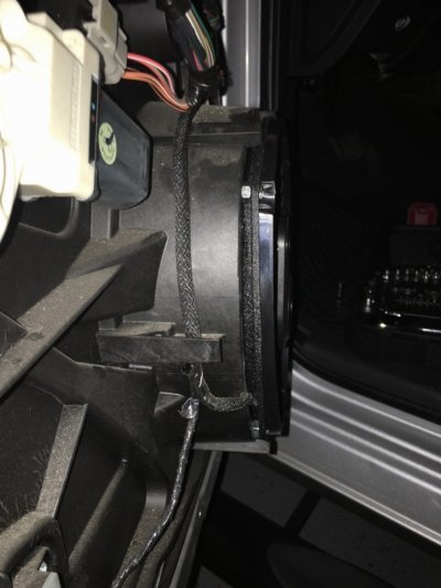

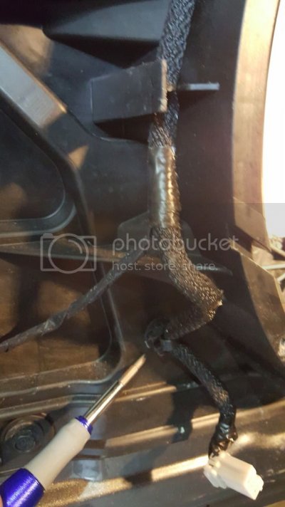

Speaker wiring harness was relocated to here.
After the cutting was complete.

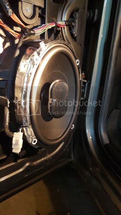

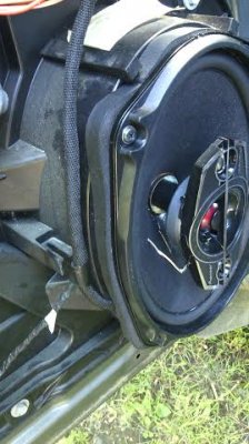

Mounted speakers before sealing edges. I used 1/4" MDF spacers bought from Amazon and added four 1/8" nuts as additional spacing. Note the relocated speaker connector outside in the lower left of the photo.
Finished the sealing used some old SecondSkin sound deadoning mat I've had for years. Super sticky on the back with a heavy foil on top. Sealed the gaps nicely.
The finished setup sounds awesome and compliments the modest Dual TBX-10 subwoofer I installed previously.

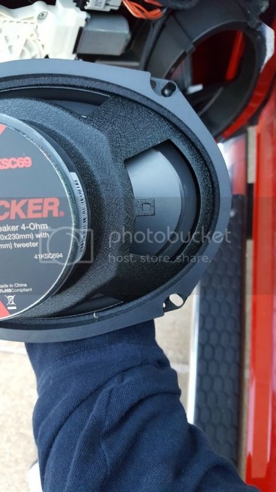

I replaced the dash with Kicker 41KSC354 3-1/2" 2-Way Speakers from Cruthfield, Item #20641KS354. They were a drop in replacement and have silk dome tweeters. Sound great, albeit LOTS of treble.
For the front doors, I purchased Kicker 41KSC694 6" x 9" 2-way Speakers, Item #20641KS694. They were listed for the rear doors, but I was able to install them in the front location.
I had originally planned to use/modify the "Universal Speaker Lift rings 6"x9"", Item #134SB69, but they were too thick.

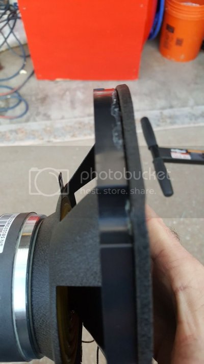

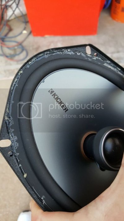

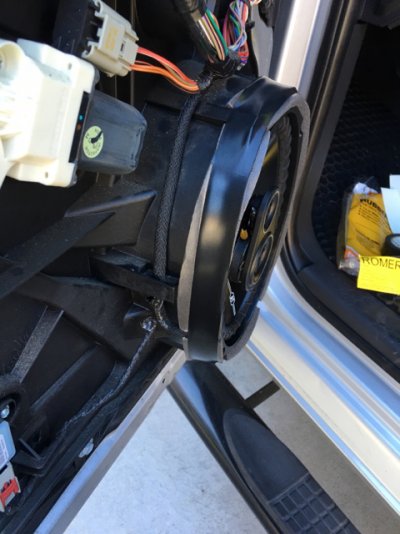

What I did was remove the Kicker 1/4" spacer on the front of the 6x9 and moved it to the back of the speaker. The spacer is glued to the front of the speaker, but came off very easily. No damage to the speaker surrounds. I used the OEM screws.
The rear supplied speaker harness worked with the front speakers.
They sound amazing, but there is LOTS of treble. I have the head unit -5 on treble, and it's still bright!
The speaker with the front spacer removed.
A side view of the relocated spacer on the back of the speaker, ready for installation.
A rear view of the relocated spacer on the back of speaker, ready for installation.
