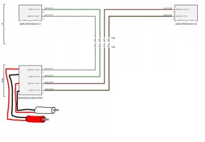

There was a forum member (jeepguy1980) who used some of the factory wiring for his subs. I grabbed a copy of his picture/post before he passed, not sure if it will be of use to you...
Edit: He had the Factory Alpine Amp/speaker setup
