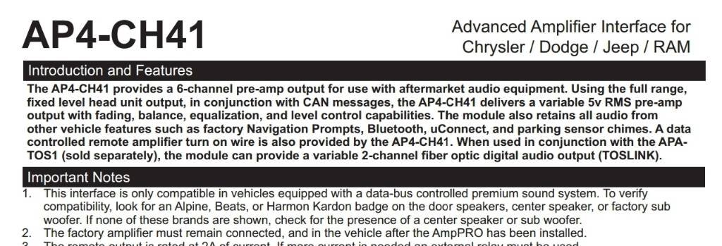

Or possibly the PAC AmpPro ? ...
Edit: only works with trucks that came with factory Alpine/ premium amplified systems. PAC AP4-CH41

That Alpine amp looks good and the install is simple and for less than $200, hard to go wrong there. That whole line resistors for the speaker puts still blows me away, never heard of a head unit that was that smart or the need for it to be? Glad my 15 doesn’t have that...
