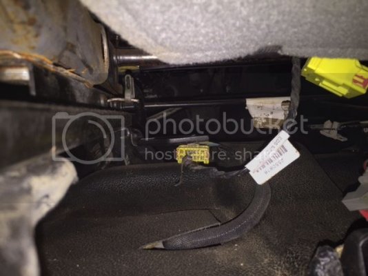

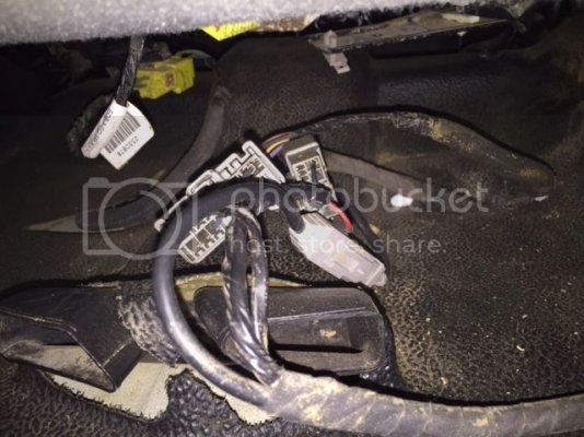

DO you know what is the difference between my 2013 Ram 2500 Crew ST and a tradesman or an SLT? I looked under the driver seat and there are 3 connectors, one yellow plug for the air bag, one small gray plug for the USB hub in the seat console, a slightly larger gray connector which supplies power to the seat console and one large gray plug maybe seat belt wiring?
What did your plugs look like with your tradesman?
Thanks for the assist :favorites13:
