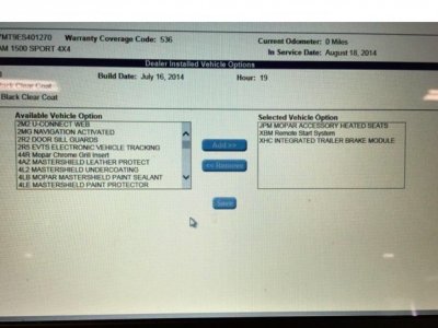

Wow I am surprised that the code was there. I am almost positive it wasn't on my Express. Are you saying that you truck actually had the wiring and your heated seats are working but you just don't have the buttons in the dash or you have the icons on the radio but the seats don't work? If you have the wiring maybe the 2500's are different than the 1500 because my Express has nothing at all.
I had the icons added with the code, but do not have the wiring for the seats.
The pic attached is not from my truck, put it is the same code.

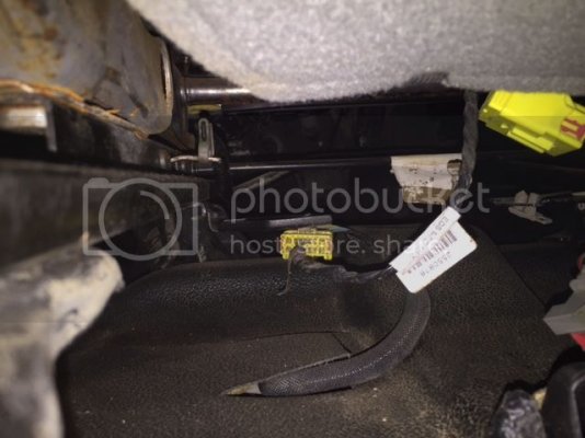

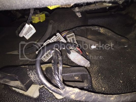

DO you know what is the difference between my 2013 Ram 2500 Crew ST and a tradesman or an SLT? I looked under the driver seat and there are 3 connectors, one yellow plug for the air bag, one small gray plug for the USB hub in the seat console, a slightly larger gray connector which supplies power to the seat console and one large gray plug maybe seat belt wiring?
What did your plugs look like with your tradesman?

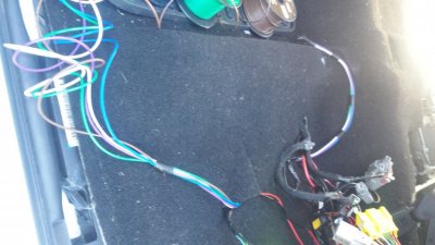

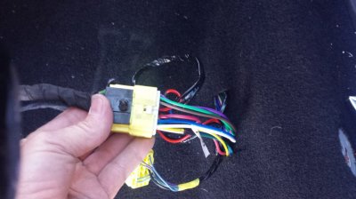

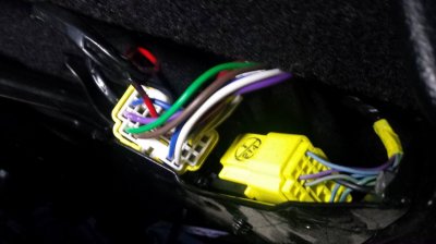

OK I finally made a little progress today. I was able to get the passenger side seat wired to the drivers side seat. If I have read the schematics correctly there are only 5 wires needed. Pins 1 through 5 in the yellow passenger seat plug. These wires will con ect to the grey 20 pin plug in the drivers seat. I have also wired my inverter so there are 5 wires in the plug for that as well. I was able to use the factory style connector and pins for the passenger side seat. I got the part numbers for the Grey plug and sockets from RT but they are out of stock. I have noticed one of the biggest problems is trying to find the factory style connectors for a cleaner look. Cutting the factory plug to do the wiring will be a last resort. I am going to call and make the apt for the relay Monday. Once the relay is installed the last steps are to install the heated wheel and clockspring and run the two wires for that and then the two CAN wires and hope for the best. If it works I will give more detailed instructions on exact wires and placement.
