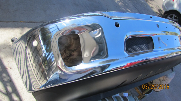

Where are you located? I can give you a free chrome bumper with light scratches and tiny dent from a tonno cover incident from a ford. Mine is off my 18 and has fog light holes and parking sensor holes. I just did a color match swap 2 days ago and doing the lower swap would take about 3 hrs if you take your time. Hardest part is swapping over all the support stuff and harnesses as you should take it all off as a unit.
Cutting the chrome openings is not going to be fun and you will need the plastic frame behind the bumper with the fog light mounting points if you don’t have them now. Then you need the factory fog light harness and hope it works if you’re able to plug it in … if not then you need the dealer to activate it in the BCM or you gotta get ALFAOBD and any supporting security bypass harnesses. You would also need to have the headlight switch with the fog light activation.
Easier and best would be to get a new chrome lower bumper on eBay for $300-400 with all the holes you want. Then get the plastic framing for $50 or so and then wire them up manually to a relay that uses your parking lights to activate a relay to turn them on that way they are always on when your parking lights are and they are automatic.
