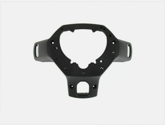

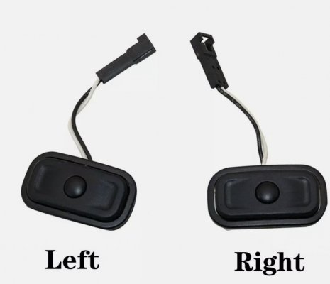

2014 Ram 1500 Express; it came with a 5.0 Uconnect Radio without steering wheel radio controls. I added an 8.4 UAQ Nav/AA/CarPlay radio (thanks MP Grimm2) and considering adding THE CONTROLS to my existing wheel. I've purchased a new rear wheel cover with switch control openings (to swap) and both Radio Control switch buttons (to install). Is there an additional wire and/or harness that is needed to incorporate the new controls, or would it be "plug n play" with the two additional wire plugs of the control switches? Thank you in advance!!

So...after researching this Forum, I found the parts I need for the upgrade, which were listed in another thread. The parts are attainable as a "kit" from allmoparparts.com
Of the list of four parts, I DO have three of them...and I DO need a steering harness. My question is now this: can the listed part number 68163713AB be substituted for 68163713AC? (which is the part number I was able to find online so far). I think the difference between the "AB" and "AC" is that the "AC" harness adds functionality of the Gear -/+ (control button) in the steering wheel, which I don't have (column shift)...

You could ask Benny in the vendor section of the form. He would know the details of the part numbers. As I understand it, the difference in the letters at the end determine the version of the same part. So AB is a newer version of the part that ends in AA and so on. The number themselves are the part number and the letters are the version of the part.

Same part, newer revision. It should be compatible.

I actually found all the parts online from different vendors...all new OEM. Cover was $37, both button switches were $35/pair...and ready to buy the steering harness for $31...so all together, about $111 w/tax and free shipping. I've had a hard time finding a used complete wheel in good shape that wasn't costly; plus adding on the shipping cost to Hawaii, gets even higher

Harness:
Type in 56046099ad to find the switches.
Bezel: reach out to 18harvest on here

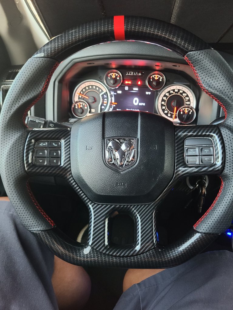

I ordered a steering wheel puller and an airbag removal tool; I'm crafty, and a fast learner, but by no means a mechanic :)-I wanted to take my time and do it right.
The tools arrived early...soo I did my carbon fiber steering wheel swap and added radio controls today ! (Friday afternoon) Let me know what you think
THANK YOU TO ALL THE GREAT FELLAS THAT HELPED!!!
Airbag removal: under 5 mins
Wheel removal: under 10 mins
Transfering wheel controls and harness: under 25 mins
Remounting completed wheel: under 10 minutes
