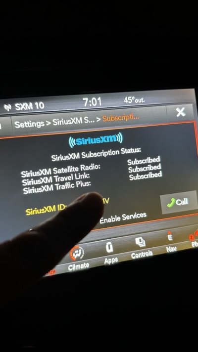

Hey, I’m in Ontario. I got 2018 radio in my 2013. Does your travel link work as part of Sirius XM?
I subscribed to all 3 services but my Nav doesn’t work or travel link service just SXM radio.
For travelink to work on the 13-18/classic 4th gens, you need a working Sxm signal/GPS and Nav radio (yours should be) but your antenna may be bad.
You also have to enable ecu config 3 setting for : Sdar TravelLink in the BCM with AlfaOBD....

I can confirm that Travel link icon is there and I can access all SXM services after enabling it with JSCAN but they all are tied to Nav. Since my Nav is not working properly ( shows in in Michigan) and im in Ontario it shows everything there.( weather,gas stations,movie theaters)

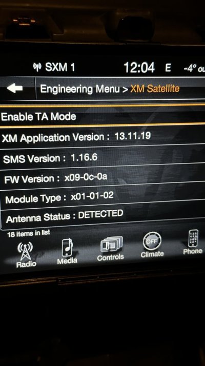

Correct me if I'm wrong @Cool_Hand_Luke but I thought the SXM/GPS wasn't working on the prior 8.4 RAx radio you had before the 4c upgrade? (I may have it mixed up, IDK)

I can confirm that SXM is working on RA4 radio and it detects antenna. Everything works as it should when I put back original radio back into 2013. Even temp controls work perfect with new dual zone ATC bezel. I gotta get my hands on that Sierra card.. if only eBay seller would be quicker in responding.
