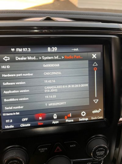

is it possible to send me the UCQ also? i have a Canadian 2019 ram 1500 with the 8.4
