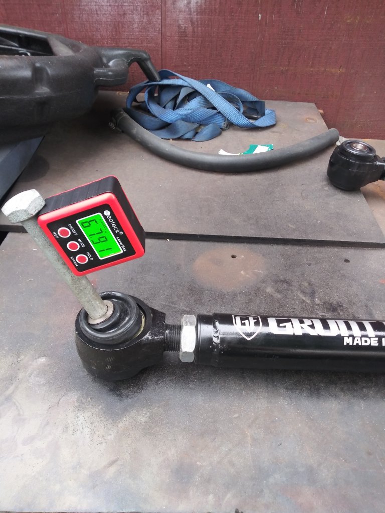

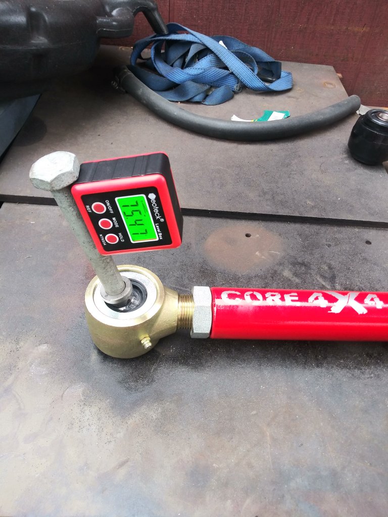

If you live in an area that has snow, and you are driving in it, trucks drop SALT on the road, to melt the ice. Snow melts, and the salty slushy snow will bind up if not greased every week.
CAT skid loaders "Recommend" greasing their johhny joints EVERY day.
You ask why...and the answer is the dirt gets in joints and were them out.
I'm not saying johhny joints are bad...what adj rear control arm you buy, should be decided on the environment you live in.
SPC X-Axis flex joints used in Grunt Fab arms, do not require ANY greasing because they are sealed. Maintenance free, and TIG welded by a disabled combat vet in the USA.
CORE 4X4 uses a pot metal adjuster nut. Pot metal is the lowest grade of steel, and will crack if you hit it with a hammer. Grunt Fab uses a stainless adjuster nut.
Plus, SPC joints flex more than Johhny joints:hands:
I apologize. :)
I was just having a little fun. :favorites37:
We all know your points on the subject :argue:
Was a little disappointed it took this long for you to find it. :favorites37::favorites37::favorites37:
