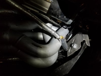

RedSRT4Me
Oct 28, 2015
2,820
2,292
Scottsdale, Az
2015 CC Sport
Here is a shot of the heat wrap to protect your lines etc.20180209_184413.jpg
If memory serves aFe provides it.
