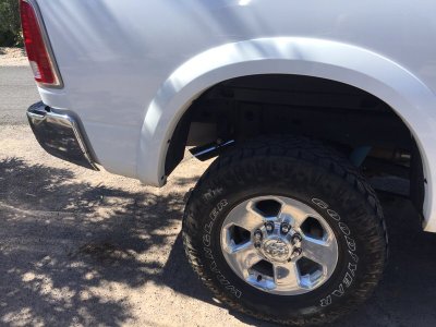

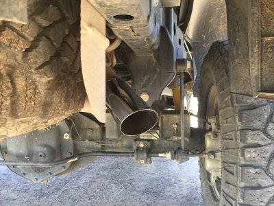

Nick, where does the exhaust tip end up on this guy? I crunched my OE exhaust outlet on a rock ledge in Moab a few weeks back and want to replace it - but I want to do something that tucks it up out of the way more than stock.
Cut the resonator off as close to the resonator as possible. Then add a short tip to the pipe. Done. Tucked up out of the way nicely, and far enough down that it wont melt the wiring harness on the back bumper.
olyelr
Nov 18, 2018
5,598
4,616
Kewadin MI
Or, if you want it, just cut the last of the pipe off after the resonator and leave it at that.
The AFE exits like stock.
I recommend for you to pick up a muffler kit like one of the ones we offer from Solo Performance then just delete the resonator as mentioned.
