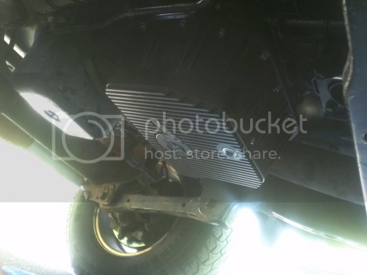

Here is the kit
I bought 2 gallons of ATF+4 at the dealership while I was there and 3 extra quarts from Autozone just to make sure I had enough
It came with a very detailed instruction manual but I will give you a first hand install.

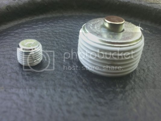

I did all the stuff needed for the pan first. It comes with a drain plug and a plug for the temperature tap hole. I put thread lock tape around both to make sure they sealed properly and installed them onto the pan

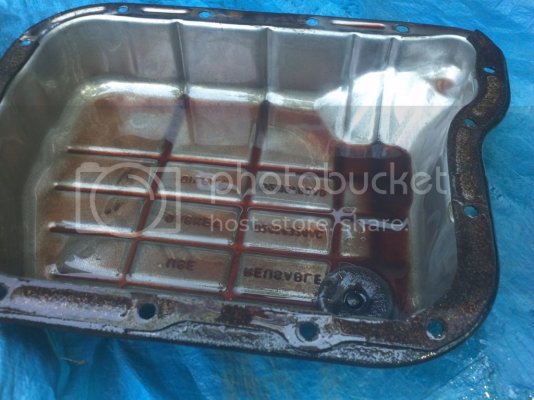

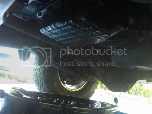

I then pulled and drained my factory pan trying to not make a mess (yea right). You will need a 1/2in socket for this
Here was my mess

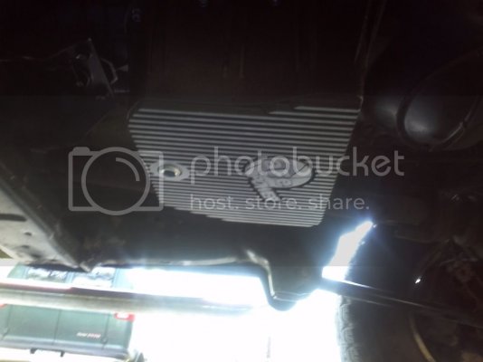

Then I just put the new deep pan on with the provided bolts and the hard plastic gasket I got from the dealership and hand torqued them down as to not crack the gasket.
It takes a Hex head socket, I just don't remember the size.
From there it was as easy as filling the transmission back up, which ended up being about 11 full quarts of fluid.
Make sure you check your fluid level while the truck is in Neutral and enjoy!
