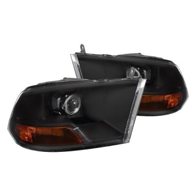

I have these on order. Review from a member here was good. I plan to add a hid kit later. 0e0544bff0d8597800fe9236c5c1396a.jpg
