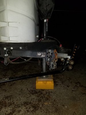

Pardon my lack of info about the Helwig.
My rear doesn't sway at all with 2 trailer antisways at $30 each.

What are these $30 antisways?

Oh I remember those. The early WDHs later came up with those as an add on anti-sway device prior to the built in designs that they have now. I know like Harbor Freight and others still have them often described as a frinction sway bar. Cool thanks for the pics.
