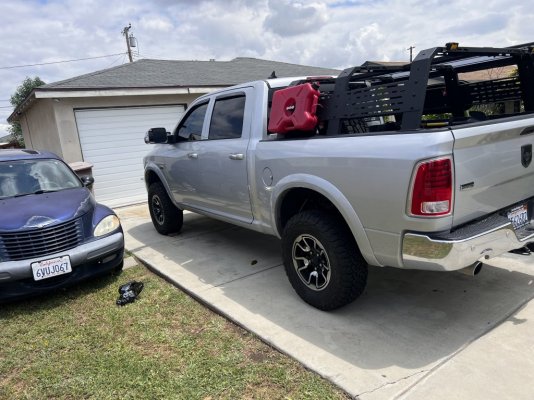

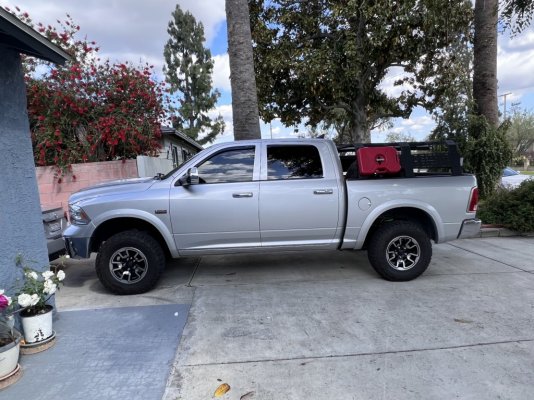

I ended up going with the medium
Load up front, and the medium load in the rear, they do not have the heavy duty in stock as of now, the rest of my delivery come tomorrow, so Thursday i will have my UCA’s and sway bar link connected, as of now i left the rear in offroad 2 and put it in tire jack mode!

@AzCats besides monroe sending me the incorrect coil isolators, and me having to drive 2 hours to get some from a dealer, the rear went on in about 30 mins, i opted to cut my fender liners right up to where the springs and shocks sit(i found it easier, and why not show off that purty green!) now im deciding if i search the interwebs for a lightweight 37, or just stick with a 35

That's awesome!! How's the ride quality?

Dosnt get much lighter than a 37” bfg at!
