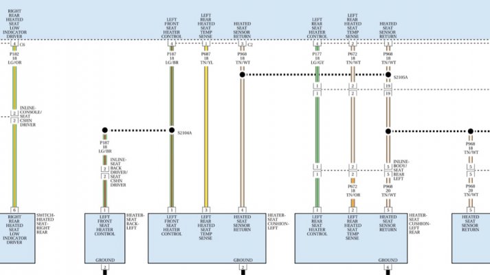

Any idea if there are aftermarket heating pads that can mimick the function of OEM?
Do OEM pads have an extra lead or two for the sense data?
Sent from my Nexus 6P using Tapatalk
I have no experience with anything but the oem pads.

Yep, I have the digrams too.
Most of the aftermarket pads Ive seen have 2 wires, essentially + and -. The stock setup has 3 and they arent (technically) + and -. I wasnt sure if maybe there was an easy way to mimick how the leads work
I stumbled on a F150 forum where someone did this but it involved a LOT of stuff, just easier to use aftermarket pads and switches, but it would be nice to integrate it all into the truck like the fronts.
I almost had a rear heated seat really cheap but turned out they only had one side of it. And for some reason the rear pads are very expensive compared to the fronts, so just buying the pads is cost prohibitive.
Connections for the seats.
