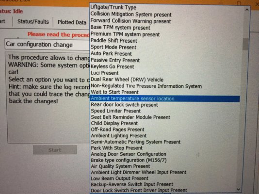

Has anyone successfully added tow mirrors to a 18? I'm in need of some help! I purchased a set of tow mirrors from 1a auto which worked great except for the flip up orientatin. After I got everything here to get up and running I enabled the tow mirror feature, orientation flipped up or down works great but now I have 0 ambient temperature reading and a check engine light. I reversed the feature but still have the same issues. Any ideas would be greatly appreciated?

Sounds like they may not be compatible. I know earlier models did not have the sensor.
Check to see if you have the following. "Ambient temperature sensor present" is not set and the "Ambient temperature sensor location" is not defined.
would I find this under "Car configuration change" as Im a little green here. I am running AlfaOBD through window too.
Here you go. If you haven’t already, it would be a good idea to create a backup of your config and upload it to Google Drive. The instructions are in the first post.

I see now it has an option for either CBC or DCM for the location. Not sure how to make it revert to not defined.
Upload your config when you can but you can also click on the "status/faults" and then "read system ID" to see what the current setting is. You have to scroll quite a bit which is why it is easier to upload and check it on a PC.
Found them set "yes". I have no clue what the diference in on location though..... CBC or DCM? I know it's in the aftermarket mirrirs drivers side
