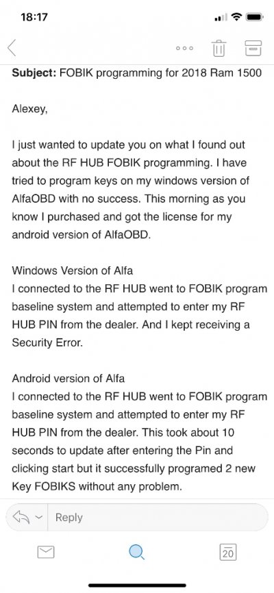

I have AWESOME NEWS.
So I tried and tried and tried to program New keys for my 2018 on windows Alfa. And I kept receiving a security Error. Well 2 nights ago I decided that I would order a replacement screen(was broken) for one of my old android tablets I have.
Yesterday I received my screen replaced it and installed Alfa on my tablet. Got everything working so this morning when I got to work I had some down time to try and program a few of the keys I purchased. It worked without a problem.
Connect to the RF Hub on ANDROID(FOBIK programming baseline system will not work with Windows version at least in my case) I’m going to contact Alexey and let him know what’s going on.
Go to FOBIK Programming Baseline system.
Put Ignition in lock position
Put un programmed key in ignition staying in lock position.
Enter your pin and click start
You will get a programming complete message
If you try to reprogram a key it will tell you. FOBIK already programed
I did this to a cheap Amazon Key and a OEM Ram FOBIK. Both are programed and working without a problem.

This looks like the exact issue I have run into with the Windows version of the App. It doesn't play nice with the RF HUB. Guess I'll be purchasing the andriod version of the app.
When I emailed Alexey the Alfa developer it sounded like he could change the code of my windows version over to the Android. So it sounds like you could get it on Android but then it would deactivate Windows. I did not have it do that but I am highly considering it.

I think I may take one for the team and download the android app and use it on my galaxy tab a to see if I can rule out a problem with the windows version of the app.
Hey. I tried the same thing on windows and it would not work. I received the same security access denied. So I purchased the android version and everything, key programming. Resetting the RF hub worked flawlessly. It’s the windows version and I already let Alexey know of the problem

I already let Alexey know the problem sir. I sent him everything debug log and screen shots of what error I was getting and everything lol
