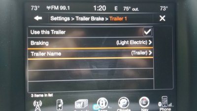

Do you have the 8.4 uconnect? Doesn't seemed to be enabled on the 8.4 from the factory. I was able to do it on mine with Alpha and now I have trailer names.

I did not have it from the factory on my 8.4 but do now.
Go to.
Active Diagnostics> Car configuration change> Click "Select option" in the
drop down below> About 80% down that list there is one called "Trailer name
CSM". Select it then select value "yes" then start
