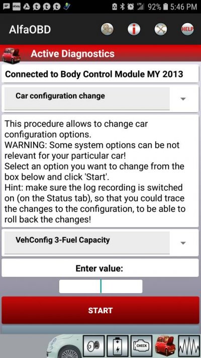

Finally got a chance to mess around with the new update on my 13. Found this in the Body Computer, anyone know what units it's looking for? Liters?3f87175e57cbe64096df016b9ac6807c.jpg

The BCM log I did with the new version earlier today shows it in liters.
Vehicle Config 3:
Fuel Capacity: 98 Liters
I have the 26 gallon tank, so that would be the correct equivalent in liters.
