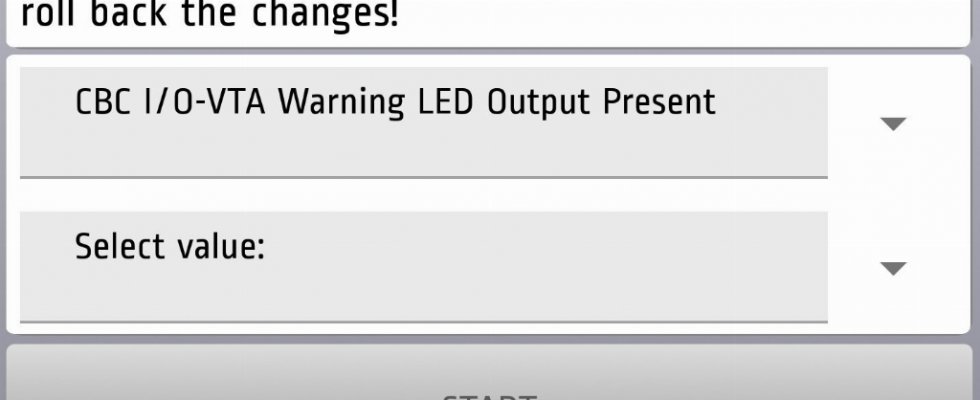

Just wanted to add that I did run across this in the options. Maybe I could enable the blinking led light manually. That is if it's even on the regular speedometer of course.
Did anyone ever try this fearure?.... if you did where did it locate it?
