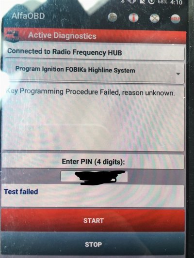

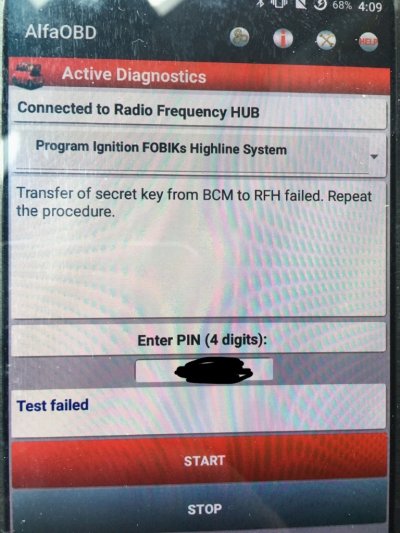

Since we were on the discussion of fobs. Got the new hub installed and key on center console. Here is what I get with a new oem fob.
I had the same issues programming. Cleared all codes and closed everything, then tried again and it worked. Took a few tries.
So after several tries of force closing Alfa and going through the process again I gave up. This was only on 1 of the 2 OEM fobs I got. I was a little hesitant on trying the other because I wasn't sure it it was something wrong with Alfa. Walked away, came back and tried the 2nd fob and it worked after the second try.
I'm assuming the first fob is either locked or there is something wrong with it. I will give it a try again later before contacting the seller.
