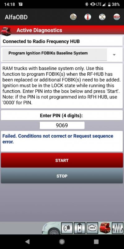

After I tried the cheap amazon one (I let that stay at procedure started for a good 10 minutes), the “known working” one from amazon took about 15 seconds after it prompts you to press unlock, and it said fobik programmed (or something like that).
Gotcha.
Will be ordering a second at some point, hopefully it goes easier then. Truck still works as expected so I still wonder if Alexi is making the BCM to RF hub magic happen automatically when you program keyfobs. Looking at the service manual procedure for replacing the hub, it does tell you to perform hub reset/replace, but Im curious exactly what that would do in my case since I never had to do it in the first place.
