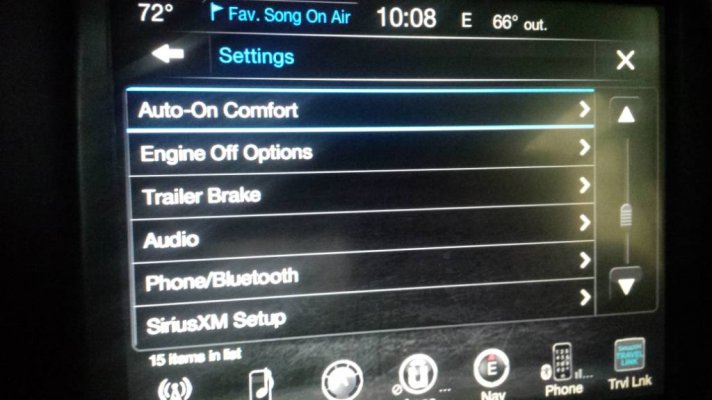

Are you looking on the settings menu on the radio? Sorry if you have checked there just wanted to make sure. If you have already checked I reccomend letting the truck sleep for at least a day if you haven't already. The UAS and UAQ radios take a long time to show the codes when they are added. 0cea31f5ae8bd822e8fcc295029e3f9f.jpg
You were absolutely right. The "trailer" menu item finally showed up.
