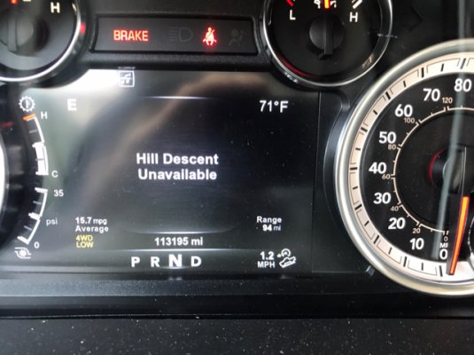

I think there is more needed for it to work. I tried it but no luck. Picked up a switch bank that had the option when I did my Laramie seats but only get a message saying it's unavailable. Also live in VA and it's as flat as my ex-wife out here. Not sure if it needs a certain grade to work. 27a9d960b58dd10d96f8f30d6710cccb.jpg

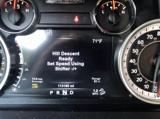

So I stand corrected! I had the e-brake on [emoji2361]
It works. Can't adjust the speed though. 0.6 mph is a slow crawl lol 8b946160e8070e25f3d5eb329292a143.jpg
Flatter than my ex wife lol! I bet we would have to have a newer cluster in order for it to show on the EVIC since it wasn't an option on the earlier Rams. I know we have had other options that they can't display. Especially the 13 clusters.
I can swap a 14 cluster in real quick and see if it will come up. Pretty sure the one I'm running right now is out of a 15. My truck is a 2016 2500 6.7 if that makes any difference.
So confirmed it doesn't display on a 14 cluster. I'm positive the one I had in before was a 15. So I'd 15 up clusters should be good.

Adding HDC works just by adding the switch and using Alfaobd on HDs at least. Awesome. Need confirmation it works on 1500's.
