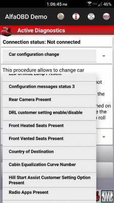

Can anyone confirm there’s an option to turn on the cooled seat funiction? I installed limited heat/cool seats, the center console with rear seat switches/harness and the correct bezel with switches.
I had power connections already from previous seats. No heat from factory.
The new seats heat will work with the bezel buttons. The rear seats do not. The cooled options also do not work.
Yes there is definitely an option there to turn them on. I have not done it with this tool because I activated mine with the AE tool but it's got the same settings the AE tool does so I don't see why it wouldn't work. STecoD did turn on his rear heated seats with it and it worked fine.

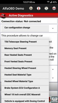

It looks like the option is thereView attachment 136464
Can someone confirm that the front vented seat option shows up 2x in the list. To successfully turn on the feature we have had to enabled it in both ecu3 and ecu5. I know the developer doesn’t filter by ecu (which would be a nice option) but there should be the ability to activate that feature at 2 different places. It looks like the screen shot is the ecu5 settings since it has the material type in it also. I don’t have my truck with me right now to confirm the settings on alfaobd.
