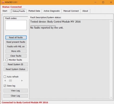

Thought I would also post some shots for the Windows people we have here. It is essentially the same. Instead of the symbols you get at the bottom of the screen on Android, in the Windows version it is a menu bar across the top.
Status connected..
Program customer features menu..
Car configuration change menu..
Example of making changes in car configuration change menu...
Example of reading system ID
Checking for faults

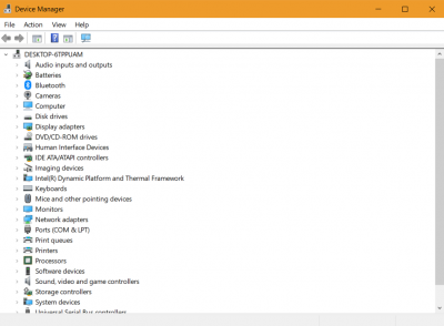

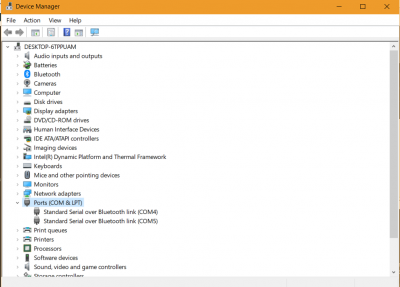

Edit: If you have trouble connecting the first time like I did and it is giving you a COM error. Check the COM port number in Windows Device Manager. Once you have device manager pulled up you should see the following screen.
Expand "Ports (COM & LPT)
Take note of the ports yours has listed. There must be two COM ports created by Windows for the OBDLink interface for the incoming and outgoing. You need to select the outgoing port in the program (see the Start tab in advanced mode). Just try both ports, one of them should work. Alternatively you can check which port is outgoing in the Windows “Bluetooth devices”.
Credit to dev
"The "Port" won't be there till it's created. Connect the OBD MX to the computer then check Device Manager for Bluetooth/COM port numbers." @crash68
https://www.ramforum.com/posts/1883141/
