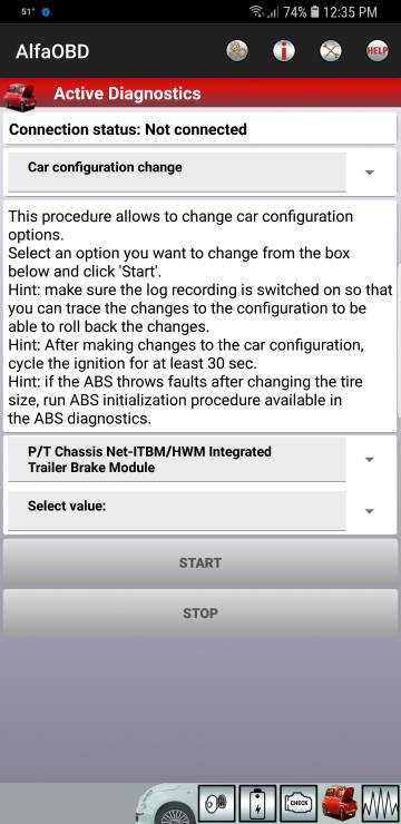

Along with the trailer select, name and type set to yes, is this the other setting for the trailer brake controller? TIA3ecd44fbcf0f69335f936fa867a41e3a.jpg
