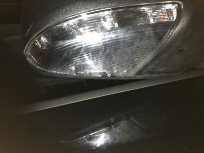

Ok then all I have is what is on the mirrors that I posted.
Seems awful big clear lenses for just a marker Light I will have to look closer when its daylight out
My truck is a 2013 and it looks like it has a bulb for the bottom lense and then the yellow bulb for the side marker
You are correct. That mirror has turn signal bulbs and side lighting built into one. The other picture that was posted is the bottom of a tow mirror. If they aren't turning on they are either burnt out OR you have the dimmer switch turned all the way down and your interior lights aren't turning on too.

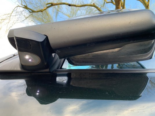

It's still daylight here but this is a picture of my approach lights when they are illuminated so you can see where they are. Unfortunately you cannot just replace the LED bulbs. This is a non serviceable part. You have to replace the entire light assembly as a unit. They run between $70 and $80 each. It would be very unusual to have them all burned out but I guess it is a possibility. the correct codes to seem to be set in your truck so I guess that would be your next option. I would replace one side obviously and then see if it worked and then replace the other. If you replace one side and it does not work then your lights are not the issue. You can also pull the door panel and check the proper wires for curent before replacing the mirror light assembly.
