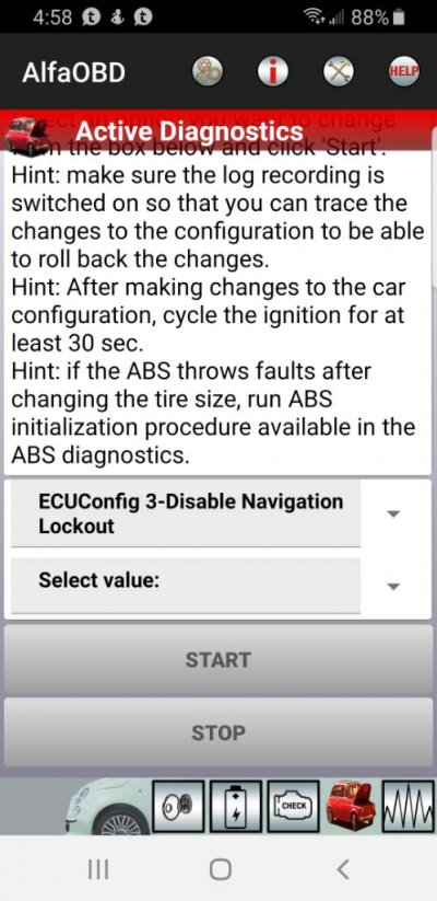

I agree but unfortunately it doesn't seem to be something that we can enable the the tool. Another one that doesn't seem to work is the navigation lock out while driving disable. Even though we set the code you still cannot enter an address manually while driving.
Where is you find the nav lock out setting I don’t see it anywhere

Did it work for you?
No. We enabled it but there was no change. We still could not add addresses manually while the vehicle was in motion. We tested it in a 2014 and a 2015.

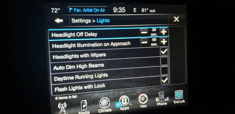

Just follow those and you'll be fine. If you have the 5.0/8.4 radio it could take up to 24 hour's for the setting in the radio to appear
i got them all turned on, but the option to turn them off and on in the uconnect is not showing up. I have an '18 with 8.4N. I have looked in the lighting and safety/driving menus.
I turned it on in the customer set menu 1-Daytime Running Lights CSM in alfa.
is this what may take up to 24 hours?
edit, I just checked that they are enabled
I turned it on in the customer service menu in alfa.
Yes. It's different for everyone no idea why. In my 18 with the 5.0 it took about 10 minutes to show up.

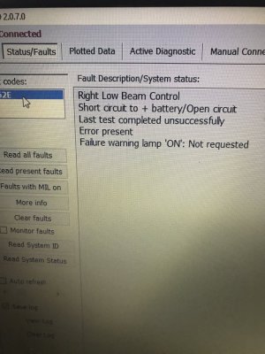

Not sure why but I’m getting this when one of my low beam lights don’t turn on they are hids
the menu was actually named "custsetmenu 1 Daytime Running Lights CSM"
I switched that to enabled/yes.
That was the only tab that had "Daytime Running Lights CSM" in it. I looked through all the tabs. Is there another one?
I just rechecked to see if I did indeed enable it, and it is.
I looked through all the uconnect menus again. I did not see the ability to turn them on/off anywhere. I would expect it to be under the lighting or saftey menus?
thanks for the help

I don't remember off hand where it would be in the radio settings but would think it's under lighting. I'm not near my truck right now to double check.
thanks for the help
Yes it should appear under the lights section in your settings menu. b64c5afb9a78c7641531aa3dbb83936c.jpg

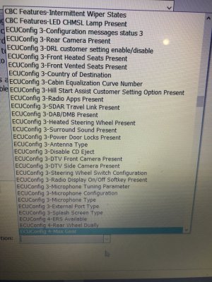

I've read through quite a few of the pages. Last night I calibrated my speedometer. Fortunately with success.
Is there a setting to disable tpms, I see where the threshold is. I need 3 sensors for the truck and just don't care about the feature so I don't feel like buying new ones.
Also can I disable the rear bumper parking sensors?
