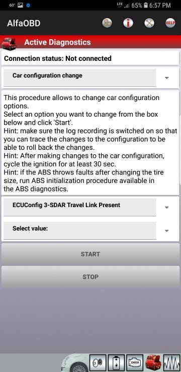

I set this to YES but travel link isn't showing up in my UAQ...any idea why it wouldn't be showing up?10af1cb802c67639ef765a2356de3699.jpg
Give it at least 24hrs. The UAQ/UAS radios take a while to read the BCM.
