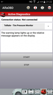

Arkansas
This is under instrument panel has anyone used this. Thought it might help disable tpmsScreenshot_2019-03-27-21-22-18.png
CincyCuda68
Aug 28, 2018
1,241
953
Ohio
I obtained my 4 digit key code. Do I have to enter it somewhere? I changed my tire size successfully without having to enter it anywhere.
You only need it for certain things in Alfa such as TPMS, resetting RF Hub or programming Fobs. Most changes do not require the pin.
