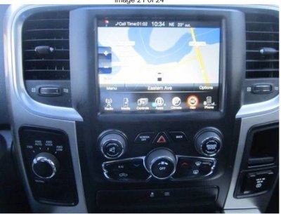

On a 2013 with the Alpine stereo system can the AlfaOBD program retrieve the radio pin code.
Here is pic of my radioView attachment 160724
The Alpine system uses the same radio as the standard 8.4 system. We haven't been able to retrieve the unlock code for the radio with the tool at this time.
