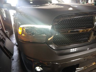

I will be doing an HID conversion and will be using converted standard headlights from a previous project. I took regular stock headlights and cut out part of the reflector to make room for Morimoto projectors. They worked really well in my previous truck and I want them back in my '16.
I could delete the DRL's altogether and use a DRL module for the signal lights but would rather go through the BCM with alfa.
Just to throw an idea out there since your opening the headlights to modify them. If came up with something to use a a DRL inside the headlight housing, you could add the dedicated DRL outputs
I thought of doing something similar to you, putting MLED projector inside the OEM Quad housing.
Then I came across the Modifystreet headlights on this forum. I added the dedicated DRL outputs to my truck and have that running the brow lights.
You can get the DRL wiring pigtails from M² Mods

Crash and 1500, many thanks for the info. That sealed the deal for me!
@crash, those headlights look great. I won't be opening mine again. it was a real job the first time!
