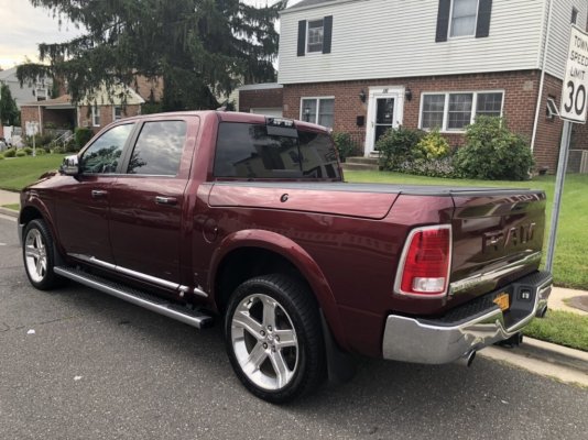

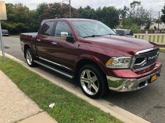

I have been away traveling for work and then I was our anniversary since the first week of August I haven’t done much to the truck. Finally got around to installing an OEM third brake light with camera, since I bought it used I figured why not install a new gasket and wash the truck to see for any leaks. So far no leaks!
I did get a message on my dash brake light out initially, it went away after I drove it around for a little bit. Will I see this message again? Is there something which needs to be enabled on my truck? I am in the process of having the harness made from DeereGuy.
You need to set the setting for "CHMSL LED PRESENT" since the OEM third brake light uses LED's.
When you get the harness installed for the cargo camera you also set the setting for "CHMSL Camera: Set" (from "not set")
I did this exact same mod using the harness from DeereGuy. Harness worked perfectly and really not hard to do. Any questions let me know, glad to answer......
Thank you very much
