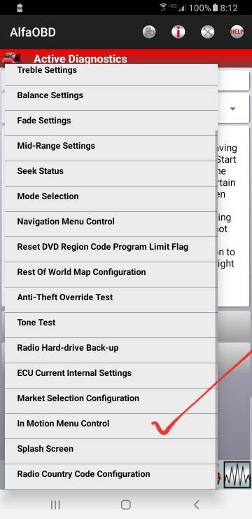

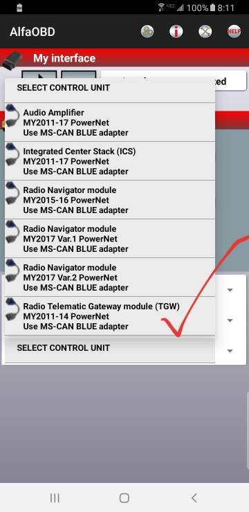

Browsing the Audio menu, I get to
RADIO TELEMATIC GATEWAY
Then,
IN MOTION MENU CONTROL
Then,
OVERRIDE OCCUPANT INFORMATION
with the option to enable, or disable.
Has anyone tried to modify this setting, to get Nav In-Motion?
Then,
Then,
Then,
Then,
Bob
Where did you select the first picture to get to that I’ve been looking for this but never find it what is the audio section

It’s Radio. Option right about RF hub
Not sure if it shows up once a nav radio is installed, but I dont have most of the options in the Radio/Nav drop down.

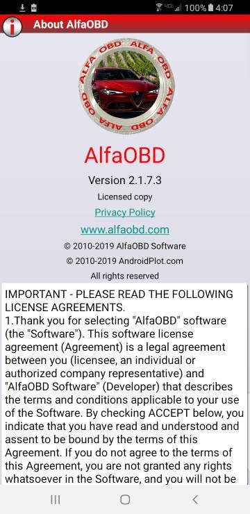

My Control Unit dropdown values are different than yours, I do not have the Telematics gateway.
Do you know what version of the app you are using?
2.1.7.3
