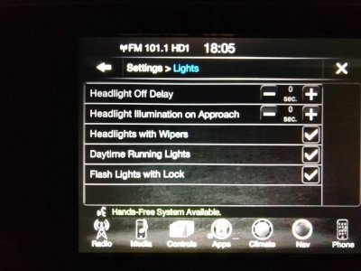

How do you guys add the day time running lights option to your 8.4 radio settings to turn them on/off? I’ve seen a few pics of trucks with the option on the radio screen. My Canadian truck has them enabled from the factory, confirmed the setting is set to “yes” via alpha odb, but would be nice to have the option in the radio settings menu to turn them off conveniently since the truck is in the US now, without having to go back into alpha.
Do you have "CustMenu 1-Daytime running lights - CSM" under Car Configuration Change in the BCM settings of AlfaOBD?
If so, set it to Yes.

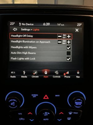

confirmed I have everything set to this below. DRLs are now turned off but no option in menu? Should be under safety and driving in settings right?
Pretty sure it's in the lights settings
The menu option on the 8.4 for the DRL is: Lights.
It should look something like this:
Rocket....you do not have the CSM to turn the DRL's "on" or "off" because you have the DRL Configuration setting set for CANADIAN. DRL's are mandatory in Canada and therefore when set to the CANADIAN DRL the CSM function to turn them on or off is taken away. Also with the DRL COnfiguration set to CANADIAN you do not have the option of choosing which lamp to use as your DRL. Go back into the BCM and:
1) DRL Configuration: OPTIONAL DRL
2) Set which light you want to use as your DRL---"DRL LAMP LOCATION"
3) DRL DropOut Enable: YES
4) DRL Customer Settings ENABLE
5) Daytime Running Lights CSM
You probably have most of the settings done already, so just check to ensure. The biggie is #1.
