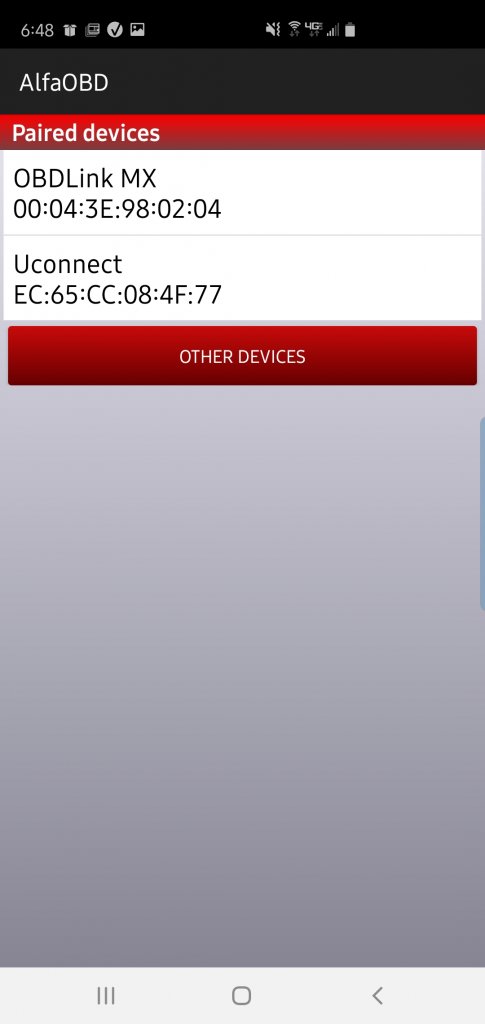

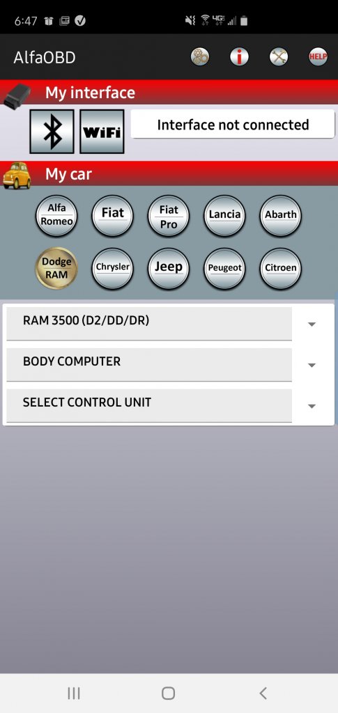

Did you try the RESET button on the OBDlink MX?
Reset not sure what u mean. Did I hit the button on front lower right to set to PAIR mode. Sure. I also un paired it and re connected. It did. Showed up in "paired devices" just never showed as connected. AND it would always connect to the ODBwiz software. That's what is confusing. Like its locked. I remember from other programmers the dongle only works with there software. I know there is a crap ton if users on this forum making it work juuuusssstttt fine.
Are you tapping the bluetooth symbol which will take you to the paired devices screen, then tap obdlink? It should connect when you do that

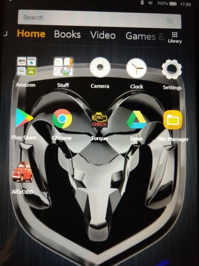

I bought a Amazon Fire 7" on sale for $30(normally $50) to run AlfaOBD. I side loaded the Google PlayStore on it, there is directions all over the internet on how to.
It runs AlfaOBD fine and the larger screen makes the text and data easier to read.3c81928297c65647330804f5a8e51ce1.jpg
I did the same thing and got the same price too.

jvbuttex
Aug 5, 2016
335
169
I-6
@superjoe83 thanks for the tips... the phone/android app seems to be working. will test the laptop later. I tried BigDaddyHouse youtube video of backing up your data... tried it, file uploaded, but empty. It might be because I am using a DEMO version. I will pay and get full version today and retest. still on fence of Android or Windows version. I like laptop bigger screen, but lots of users seem to use the android version.
