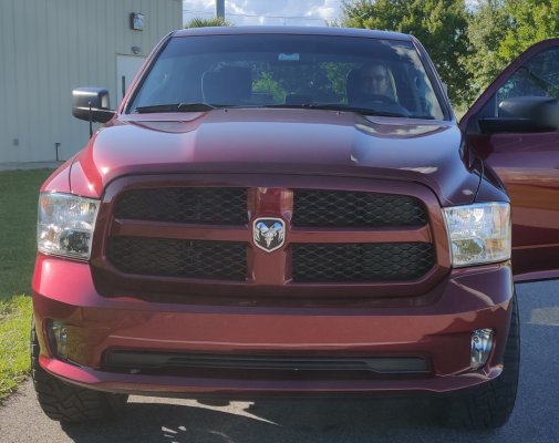

Im using DRL with low beams Led's, no issues, didnt need change bcm to leds all i did was enable drl settings no flickering no issues at all7cfa9c39016e4220f13ad3bfa1f4a0c5.jpgd7ed89497ef1f0372edba616ac57f216.jpg
