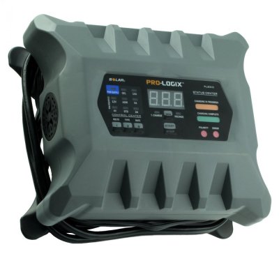

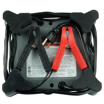

Thank you all for all the information! I just purchased a "new to Me" 2017 Ram 1500 Big Horn from CarMax. As it was a fleet vehicle, I only received one FOB. Not wanting to get stuck in BF Egypt running from a storm with a broken FOB, I got two more online. The dealers around here are good, but slooooooow, and guess what it's storm season again. I have the latest android AlphaOBD and the Blutooth OBDLink MX+ for my 2016 Jeep Grand Cherokee. In thanking you all, I have a few observations to pass along with programing the vehicles. First and foremost, as an ex-computer technician I 1000% agree with the sticky. The First thing you do when connected to your Vehicle is BACK THAT THING UP!!!!!. Alpha is so powerful that it's dangerous and without a clear instruction manual on how and what to do, you can easily go places of no return! The second is something that I got from the Jeep Forum but often gets overlooked. When programing the body computer or really doing anything with Alpha, always have the vehicle battery hooked up to a power supply so as to maintain a steady voltage of at least 14 volts. Not just any old charger mind you, but one that has a dedicated monitored power supply function. I use a Solar Pro-Logix charger, just for this reason, it has a dedicated power supply function that is critical for programing the body computer and maintaining a steady state of power. The reason is that even minor voltage fluctuations from a discharging battery can act as code scramblers and fuddle fingers in the rewrite process. leaving the TIPM and Body computer half coded and locked up as confused. With what we are doing to the vehicles it's really a no-brainer to purchase one and use it. You will find that many of Alphs's hiccups go away. Lastly, as I was doing a simple FOB reprogram I used Alpha to get the security PIN for the Radio beforehand, 2017 so it popped right Up :cool:. Always have any necessary codes or steps down pat before actually attempting to make alterations. The shutdown and reboot cycle of the vehicles with the android version is something Alpha needs to look into as it's really poorly defined and simply waiting 5 minutes for a computer rewrite seems a bit iffy with some of the body programming.
