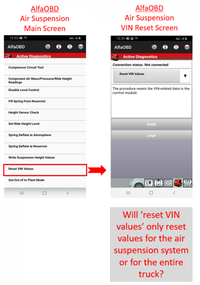

Has anyone used the 'VIN reset' feature of the Air Suspension in Alfa OBD? If so, can you tell me if the 'VIN reset' feature only resets the values for the air suspension only, or all values for the entire truck?
I've included the 2 screenshots below as a reference

... @Roman217 may know

This only resets the VIN values on the module and forces it to grab the VIN from the BCM / PCM. It does not work on all modules due to security levels required to clear VIN values.
It did not work for me when I installed an air suspension module in my truck. I had a friend that worked at FCA that had the engineering tools to try to clear it and that didn't work either. We had to run the "Initialize ECU" procedure to make it pickup the VIN.
