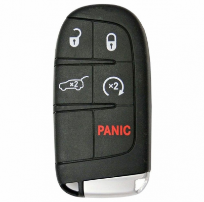

Thank you for your response, but I'm a little confused. My Jeep has no place to "insert" the fob - my fobs are not keys and not FOBIKs, they're button-only. Where you would expect an ignition slot, there is just a stop/start button that works when the fob is near the Jeep.
For clarity, here's an off-the-web image of my Jeep fob:
A Google search leads me to believe that at least some 2018 RAM 1500's use or can use a VERY similar fob:
Is what I want to do possible?
If programming 4 fobs IS possible, do I need to do anything special with AlfaOBD? Like all fobs inside the Jeep or all fobs on the console or some magic button press combination or . . . ?

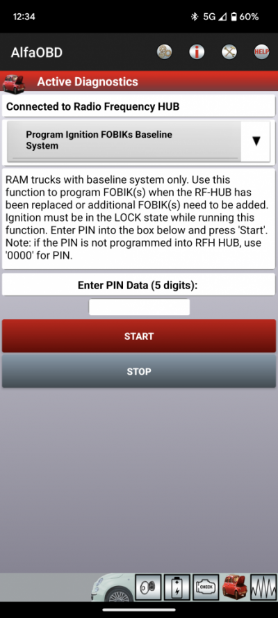

Anyone have problems with AlfaOBD on a Pixel 7? I just tried to program new FOBIK keys to my truck using my Pixel 7, but on the PIN entry screen, it said "5 digits", and the PIN is only 4 digits. I tried multiple times and the procedure failed. So I went back to my old Android phone (which still has AlfaOBD on it) and tried it again: it says "4 digits" which is normal, and the keys programmed perfectly. My Pixel 7 is up to date, as is the AlfaOBD SW. Strange SW bug.
Does anyone have a fix for this that isn't just "have an older version of alfaobd available"? I just got alfaobd today to try and program new fobs, but it asks for 5 digit pin. Of course the pin read tool only gets a 4 digit pin. Any help would be greatly appreciated, was there somehow an OTA update to all Rams requiring 5 digit pin for fob programming, or is this a glitch in the newest versions of alfaobd?

@Prototype4342
Just looked on my Alfa app and it only asks 4 digit pin for both base and highline system. Sounds like something is amiss with your setup. Double check all you settings for AlfaOBD to confirm that you've chosen the correct vehicle - module - powernet. Is software up to date on Pixel OS. Just because you just got Alfa, check for an update. Is your dongle software current? Could also try turning on Airplane mode on phone. That way, no unnecessary signals that could be giving you issues. Hope this info helps get you going.

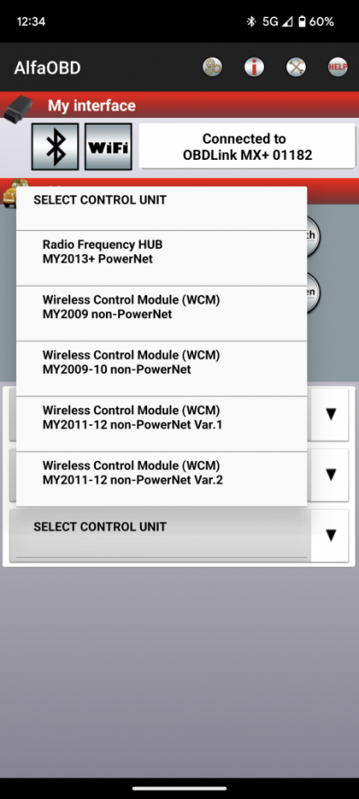

Ok, I updated firmware on my obdlink mx+, still no dice. See the screenshots for what I am seeing. On the first screenshot I select the first option MY2013+ PowerNet (truck is a 2016 outdoorsman ecodiesel). I then select Program Ignition FOBIKs Baseline System, which is where it gives me the second screenshot.
Seems like an alfaobd issue to me unless something is just odd about my truck in particular. It's funny because the stated default pin is even 4 digits.
I think I remember when I pulled mine reading a couple posts about a 5 pin, but I only got a 4 pin on my '18.
I read the code just so I had it if I needed it.
Did you try your 4 pin? Maybe it allows 4 OR 5 pin, and the dev just screwed up the graphics side?

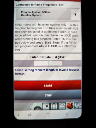

It's definitely a software bug of some sort. I still see the problem on my Pixel 7, but not on my older phone. Interesting note: when I first got my Pixel 7 last fall, AlfaOBD wouldn't even work on it. I contacted the developer back then and he wasn't sure what was wrong (he's a great guy, btw....I've chatted with him multiple times over the years). Now it works....but does the 5 pin thing.

I would say it is an Android version of AlfaOBD glitch. The windows version worked perfectly for me.
If it wouldn't be another $50 I'd just get the windows version also.
I may grab an old phone and see if it'll work that way. Since I purchased alfaobd through the play store it should allow me to download it on the old phone as well.

No luck using my old phone either. It's asking for 5 digits there as well. Is there a way to revert the alfaobd version? Also, I tried to add just a 0 to my pin before and after the actual pin and I get the below message. When I just type my 4 digit pin it simply says "procedure failed". Seems like it is still expecting 4 digits but the 4 digit pin still fails? I have heard the 5 digit pin includes a letter at the beginning but no clue what that might be.
