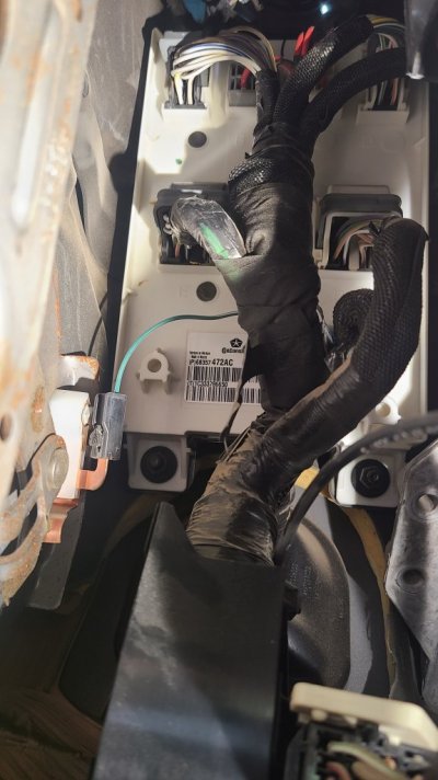

I cant find the thing to plug the thing into. My underdash computer doesn't look like the other ones I've seen.
This is by the driver left knee.
And what I was hoping to plug in
This looks like the same cable I have installed from Z Automotive. It’s a SGW Extension Cable. It is not a security bi-pass cable.
I have the Kaodtech bi-pass cable and it plugs into blocks near the steering column on my 1500
Edit: after checking my records the red end cable is a by-pass cable that didn’t work for me and I used the Kaodtech because of it not working. Sorry for the confusion.
