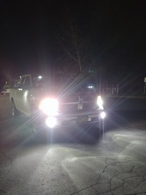

I'm kind of confused.. I have the OBDLink MX Bluetooth, and the demo of alfaobd.
Do I need to buy the full version before I'm able to see "car configuration"?
I'm going to try to get fogs + high beams together working. I think I read this somewhere, but wasn't going to buy until I saw the setting.

You would need the full version to get this option. It was the first change I made.
